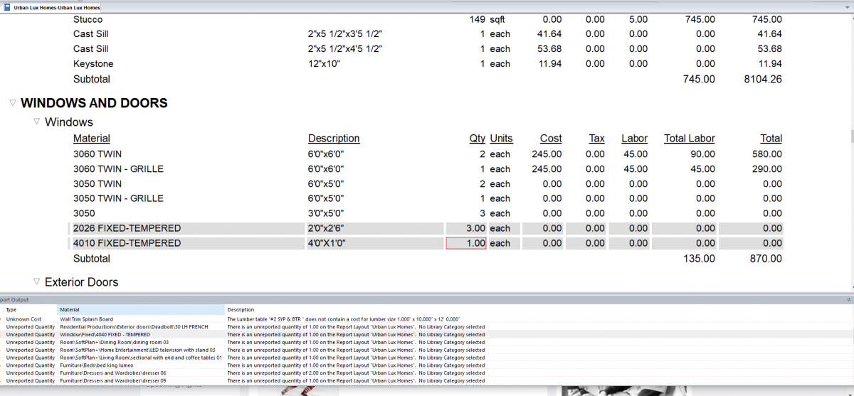

So when generating report, along with some other errors (mostly that it is trying to count notes) it states that some of my window have the error of "No library category selected".  At least one of these errors comes from a window that is in the library that has windows  that are being counted no problem.  I am not really understanding this error message so I am not sure where to start/go to fix the problem (I have manually added the windows at this time)

Good morning Tom,
Sorry about the delay, I don't log in every day.
This happens a lot with me as I pull in co-worker drawings to check the Softlist report(s). So my "system" sees a lot of "new" openings the individuals may have created for their drawings.
So my libraries expand ... a lot.
Technically you can double click the window in your exception area and the Library this window resides in will open.
When it does you'll see Library Category is most likely blank due to it being a 'new' window. Just select the drop down list of Library Categories and choose the appropriate one.
Most likely choice would be your "Windows" category. But your system and report method can be very different than mine. Also while in the Library check your NAHB code for the opening
in question. It has effect on where in your report the item lists.
An alternate is to go to System Options Softlist Configuration Libraries and open the Openings library (doors/windows). Then select the specific library your window lives in. Once open you'll see the column tilted "Library Category"
Get the category changed to the correct one. I'd assume it would be "Windows" but the system allows a lot of customizing .. .
.. Also check the NAHB code ... make sure it matches the other windows you're reporting. Else it will come out in a different row or maybe not at all.

Why would the furniture be giving me the same "No library category selected"?  When I double click it does not have a library nor is there one that is reasonable to pick from.  And to top it all off it is not even checked to be included in the material list.

If you have a check mark in the "Include " column of the Library table you'll get a notice regardless of whether the SoftList tab is checked (when you edit the actual symbol in your drawing).
You can add as many new Library Categories as you want. Go to System Options_SoftList Config_Libraries  and then click on the "Library Categories button on the lower right.
