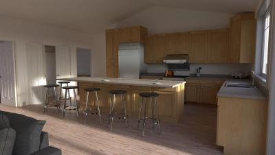

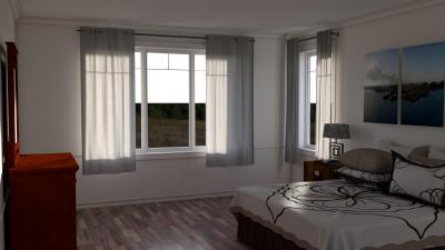

I export my 3D models to Sketchup and use V-Ray to render them.  It too has a fairly steep learning curve but I am getting better with it (slowly).  I have tried other renderers and I prefer the results from V-Ray to anything else I have tried.
