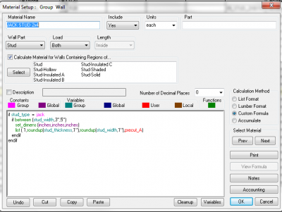

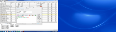

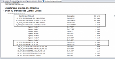

I am trying to figure out a formula to count all my studs. I do not want to split up the jack studs from the other precut studs. Our framers take a precut and cut it down to a jack stud, so I want my take off to reflect that. I am attaching screen shots of the formulas and the softlist report.
One formula has:
if not (stud type=jack)
and the other formula I took that line out hoping it would include those jack studs in my overall stud count.
But...both formulas are giving me the same count.
Any suggestions? Thanks!

What I have that works is two formulas. One for studs and one for jacks that both report my precut lengths. I am attaching a formula that is close that should combine the two, but isn't working just right. yet. Once I export the material list to Excel, I can easily combine the studs and the jacks together using the product code I input, but I would like SoftList to do that for me!
I am not sure how to use accumulate for a custom formula. Once I click on accumulate, my custom formula goes away and I have to input the information in List form. But list form doesn't give me as many options as custom formula does.

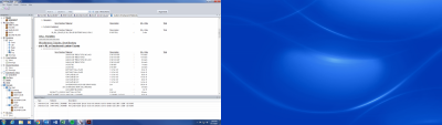

Has the formula you posted above worked for you. I tried it out and i counts from the shortest precut on the wall i designed to the longest precut defined in Softlist. See attached snip off my Softlist Report. I have the wall designed for the 88" precuts "precut_A". I starts using this one and adds the other two precuts. Looks like using lin. ft. of studs required. I just sent this off to Tech. Support. I did copy the formula to each precut and changes the material width size and change the precut letters to match.
