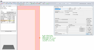

Posted 16 February 2018 - 10:18 AM
Here is the results from structural slab with footing. The results are dead on twice the parameter for footing rebar
