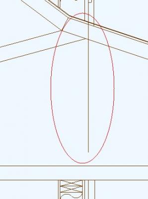

Sometimes, in Cross sections there is a line that I cannot edit, adjust or delete. It does not respond when I use right mouse click or cross erase or anything. Any ideas?

Is this in the saved 2D drawing? If so, check to be sure all layers are unlocked.

Everything is on Default layer

    This has happened to me once in a while. I believe "block erase" will remove it.

Thank you very much. Block Erase did it; Cross Erase did nothing at all!

"explode"  ??

You can't explode it ... if Softplan can't see it to edit, delete or erase it!

I could not locate it to delete, adjust, erase or explode! :(
