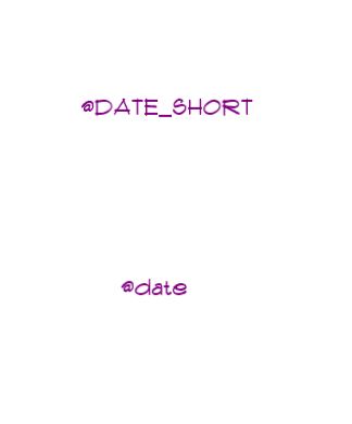

You can also create a speed note for the Short Date. Place a note on the Drawing screen and go to Stamps on the lower right and click on Stamps then click on @ Date_Short, then click ok then go to System Library under Information Stamps click on one step draw a box around the @Date_Short to add it to your speed notes. The nit will show up on your Plan Set Page as 9/9/2021. Or you can just type it in a note as @Date_Short.

Type a note “@Date_Short” then go to the system library speed notes and click on one step draw a box around the note and it will add it to your system library speed notes. If the note turns purple then you know it worked
