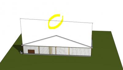

I am trying to draw a piece of dry wall and have it clip to my roof.
I have attic roof trusses in my model.
When I hit clip to roof,  it seems to just clip to where my attic truss ceiling is, not
to the underside of roof.
Any idea why?

Extend the roof in that area, then try fit to roof. Or, use the tools to adjust the wall with rakes and set it to two sections and adjust accordingly.

Not sure this is the case, but a wall on a higher floor plan will not fit to a roof that has been created on a lower floor. Just saying so that you know for future reference.
