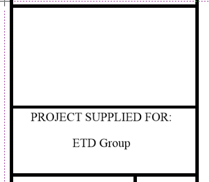

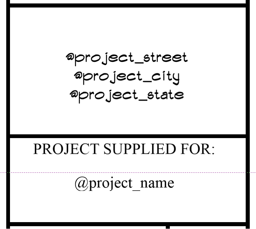

When I insert one of the numerous Templates I have created, all the address information isn't showing up .. Did the command in the template change .. I thought it was @ and then the address part you want to show up ...
Street / City  etc ??? I tried a different template and it doesn't seem to work in any of them .. (Only about about 2 years on softplan - ZERO training) so be kind .. lol
See attached photos ..
2026 Version
Thanks for the help ...

Since you are using Project information stamps make sure you are filling out the Project Information rather than the Client Information.

They will only show as specific information in the plan set. Do they work when the drawing is added to a plan set?

Thank you so much for the help .. it's working now ... 2024 seemed to work when I had the client information filled out so I assumed something was up ..
Appreciate the help ..
