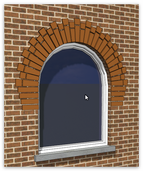

#4 Sam Allen
Sam Allen
  • 133 posts
  • LocationSan Antonio, Texas
Posted 01 September 2016 - 08:22 AM
Hey Keith...the brick trim on the round window that you helped me with looks great here.  Thanks again for the help....
