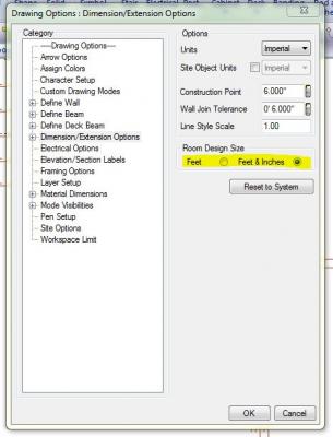

I'm just starting to use the "Design Size" in editing the rooms in room mode to show on my floor plans for my website.   Is there a way to change things so it shows feet and inches rather than just rounding?  I have a room for instance that is 14' 8.5" wide and the label shows at 15'.   I would be fine with 14' 9" but rounding to the next foot seems a little too much and maybe a little misleading to potential buyers looking at plans on my website.

Go to "Drawing Options_Drawing Options_Dimension/Extension Options". Click on the Feet & Inches" option

Thanks Phil!   I figured it had to be there somewhere.
