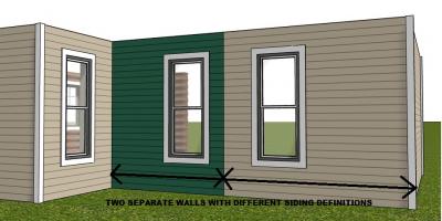

Can SP 2014 edit wall surfaces independantly  Can I change the color of an individual wall section withou affecting the whole wall or all walls?
#2 Thomas Roman
Thomas Roman
  • 366 posts
  • LocationSacramento, CA
Posted 24 January 2015 - 03:45 PM

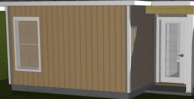

Colors are assigned to materials... so siding A gets one color, and siding B gets another... you can't tell siding A to be one color here, and a different color there... but you can use different walls, one defined with siding A and one defined with siding B... easy to edit the wall to change it from one type to another, in order to change up the materials / colors...
Another option is to use INTERIORS mode to place wallpaper or paint textures... I think you can even place wallpaper on the exterior, so that would be a way to make a portion of a wall have a different color... place a three foot section of wallpaper, and you can change the color of that wall for those three feet...
I often use INTERIOR mode items on the exterior: chair rails, baseboard, crown, etc...
