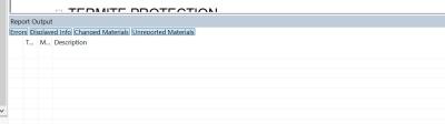

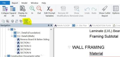

They should show up below your report in the Report Output. If you don't see the Report Output click on the Report Output button at the top left, that's where mine is.

I see your right, i just have a lot of stuff in that list as i don't clean up a lot of that, if you know what I mean,
So maybe looking for a reminder in future versions, when I setup a new material, that at that point it lets me know
I need to place it into a list.         I don't spend enough time on the program, so I'm fuzzy on how a lot works especially softlist
