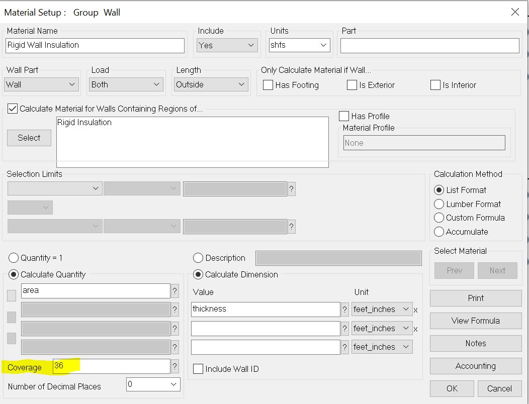

trying to figure out how to convert rigid foam from sq ft to pcs.
then if possible instead of it showing up At " FULL ENCLOSURES / INSULATION" but rather show itself inside of " EXCAVATION AN DFOUNDATION"

In the coverage box add how sqft each sheet is; like if its 4'x 9' you would put 36 in the coverage box and change the units to "shts" or whatever you want.
