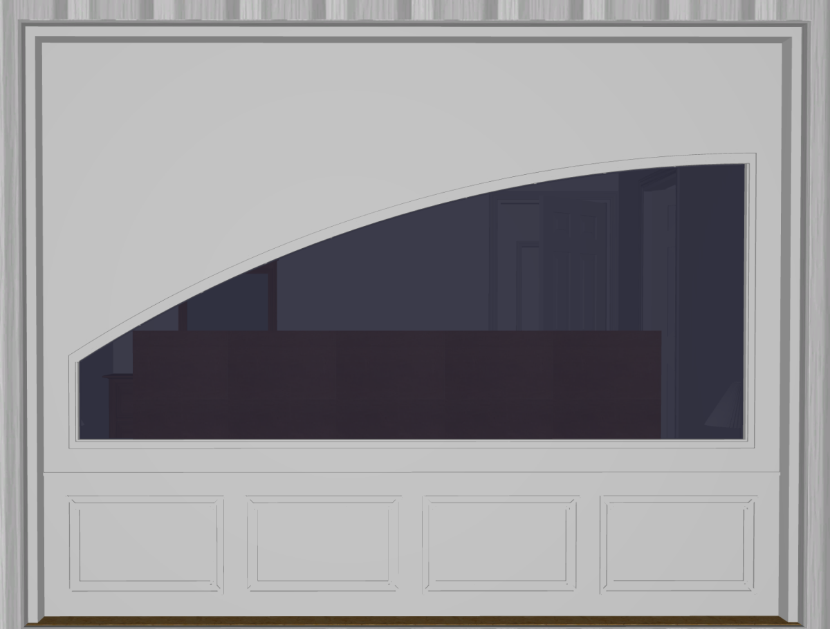

Hey Keith, can all elevation openings be applied within a second elevation opening? That's where I was getting hung up, because in the Detail>Opening Shapes>Door Glazing (Square) item, I found that I could change the shape of the top of the window, but didn't try adding different opening shapes within the Elevation Opening that I was creating.

Yes, you can draw openings in the garage door to suit. As long as you draw the glass with a dotted line it should work fine.
Not the greatest garage door design, but should illustrate the point ...
