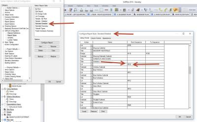

SoftList is an incredibly powerful tool but it is also very math and formula driven.
It must be this way to allow power users the flexibilty to do an accurate takepoff / material list on virtually anything in SoftPlan.
That said it takes patience and study to learn how the formulas work.
There are formulas that come with SoftPlan for 8 ft and 9 ft precut studs.
There is no formula for 10 ft precut studs so it will only report the rounded off stud size.
Rather than trying to reinvent the formula you might find someone here that has created one and also you can call Tech Support and ask them if they hacve done that.
If the windows are not showing up on the report it may be that they have not been assigned a sequence number whichg determines where they will show up.
If this is a product code window that you cretaed then you must assign a sequence number that will put it in the report.
You can find a list of sequence ranges in the SoftList.
