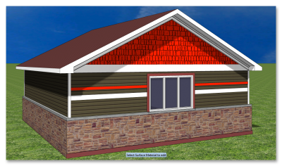

#9 Jim Johnson
Jim Johnson
  • 289 posts
Posted 07 December 2015 - 09:48 AM
  • Deron Butler likes this
#10 Keith Almond
  • 5,301 posts
Posted 07 December 2015 - 10:25 AM
Well, I'm AMAZED and ASTOUNDED, and apologise.

#11 Thomas Roman
Thomas Roman
  • 366 posts
  • LocationSacramento, CA
Posted 07 December 2015 - 12:56 PM
Keith....
surfaces can take on RELIEF DEPTH even if the surface is defined with a color... the RELIEF DEPTH will take on any texture / bitmap that is identified as the "texture", even though "Display Color" is selected for the surface
be sure you have ENABLE DEPTH RELIEF in your Mode Settings..
be sure that the surface settings have a high setting for "Relief Depth"..
clear as mud?
  • Raymond W. Johnson and Deron Butler like this
#12 Keith Almond
  • 5,301 posts
Posted 07 December 2015 - 02:05 PM
No, Clearer than mud ... much clearer.
My mode settings didn't have DEPTH RELIEF enabled. Once it was enabled, I can duplicate your results.
Thank you, James and Thomas - I've learn't something today, so it's not been a total waste of time.
Not the greatest look for shakes, but does prove a point.
So, In answer to Jim's original post, YES ... textures can be "somewhat" recoloured. I suppose the final effect is very dependent upon the chosen colour though.
