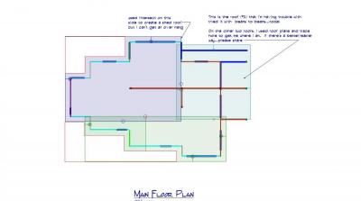

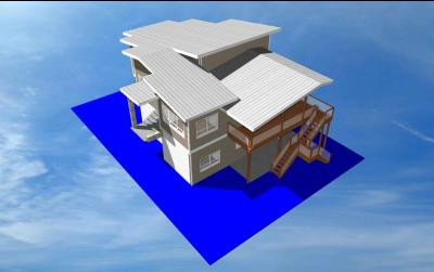

Unfortunately, this is where I am

Concept A-Roof.jpg Yes, I know there are open wall ends...just can't get them to join properly, but I'm working on it. Maybe the new patch in the update will help.
