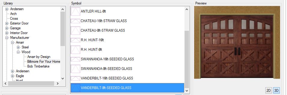

Can you do a tutorial about that? I'm sure I'm not the only one who will learn something.
How did you get the handles on the garage doors?

it's an image on a door
in / openings / manufacturer / amarr / wood
click image to enlarge
