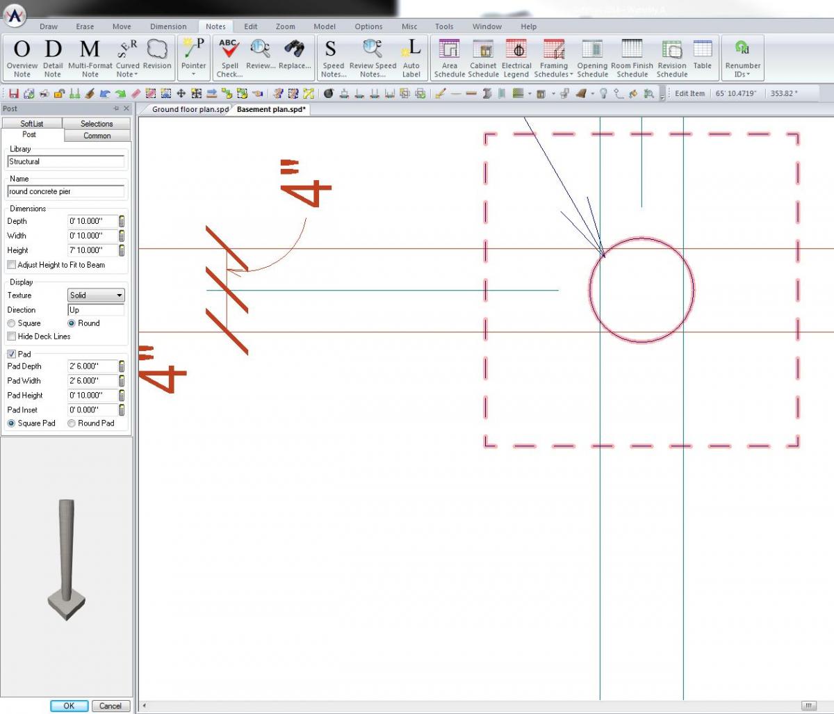

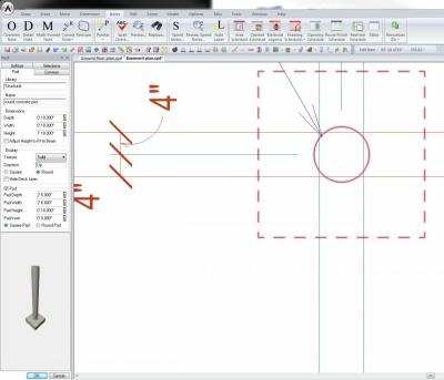

#4 Yvon Gonthier
Posted 05 June 2015 - 10:52 AM
Maybe I'm not quite understanding. This is what I have. If you don't have it you can just create one using a circular post. Or is it something else?

#5 Joshua Brown
Joshua Brown
  • 14 posts
Posted 05 June 2015 - 10:55 AM
It is something else. I know how how to get the post and pier to show. My current issue is I do not want the post. I just want the pier. Is there anyway to remove the post from the pier?
#6 Yvon Gonthier
Posted 05 June 2015 - 11:08 AM
I guess that what you refer to is that you just want the footing? Can't quite do it but just select the square shape for the post and remove the footing, you can size the post as your footing. The only thing is that it wont be dotted on the plan. Hope that helps?
