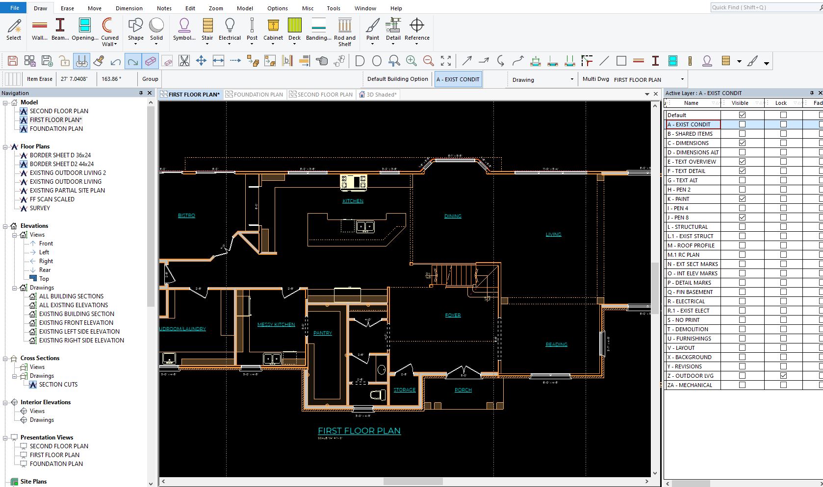

Robert - this was largely solved for me when they made the Layers menu floating and dockable (I prefer it on the right side). Now the layers list/menu is always visible, and it's just matter of clicking on the layer I want to draw on. SP highlights the active layer, so I always know where I am. Not that I don't forget to change layers now and then, but it is a huge help! Now if they'd just make the "group" column moveable...Capture.jpg

Quick note to add to the above - I also made the colors of all items in the system/project/drawing levels to be different from the colors in my layers. For example, in my system/project/drawing settings detail notes are pink, but in the layer settings they're pale yellow. That way, if I start writing a note on a drawing and it's not pale yellow, I know I'm working on the wrong layer.
