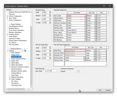

Posted 27 January 2022 - 03:10 PM
Okay, I'm going to ask a stupid question ....
Why can't you set the dimension font to the same as the detail text font?
The font setting is exactly the same for EVERY character style.
There is NO option to set the standard fonts to ITALICS ... so how did you do it?
If you're using an ITALIC font for standard text, why can't you use the same ITALIC font for dimensions.
attachicon.gif 2022.01.27_16h06m15s_001_System Options - Character Setup.png
The italics for notes can be set by editing the note, down where you can wrap the text, box it out etc.  No can do with dimensions.

#10 Keith Almond
Posted 02 February 2022 - 08:47 AM
Yes, I'm aware you can do othat ... However, that's not "I changed all of the System Text fonts to Ariel Narrow, Italics" that you said in the first post. You've had to go into EVERY note and explicitly set it to italics. You haven't actually set the System text fonts to italics have you!
