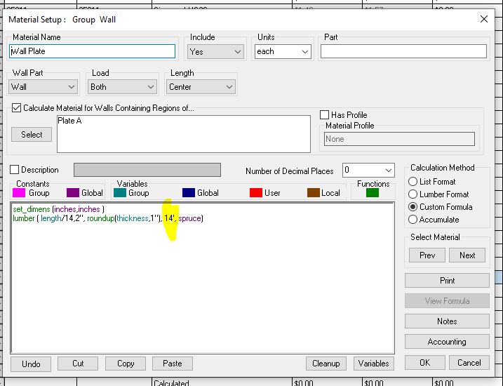

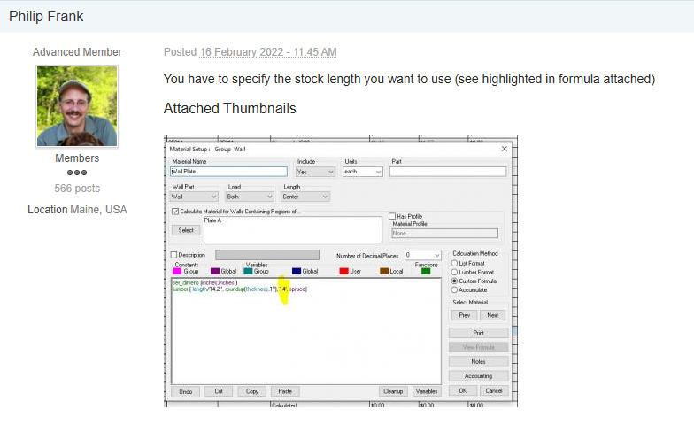

Posted 16 February 2022 - 05:45 AM
You have to specify the stock length you want to use (see highlighted in formula attached)

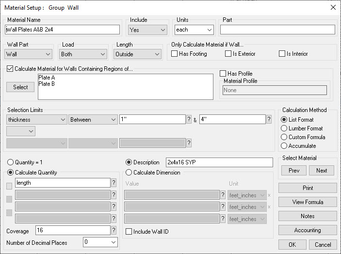

Posted 16 February 2022 - 02:17 PM
This is how mine works by getting lengths and doing coverage of 16

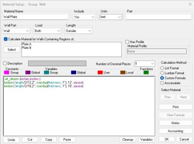

How would I specify random lengths? For example, if I had a 28' wall, how can I make it specify a 16' and 12' wall plate? Thanks!

I'm one of those guys that has always been intrigued by Softlist, understands that it can do a better job of estimating than any human as long as it has the correct information, but has not figured out how to tweak it to my liking. I've always been very quickly frustrated by it. I've used ChatGPT to help me with many things, and it's been incredibly useful --- not for Softlist. I tried having ChatGPT answer Dennis' (and my) question, but spent over an hour of copy and pasting, reporting errors, trying again, with no success. This morning I had an 'AHA!' moment, sat down at the computer, and punched it in.
Credit to Philip for laying the groundwork above.
So I only want it to list 12' and 16', so I'm taking the total length / 2, then dividing by 12' and 16'.
If I wanted to use 8' - 16' material, I could do 5 separate lines and take the total length / 5, then divide by 8, 10, 12, 14, 16.
There may be a way to do that all in one line, but once I got it I decided to leave it.

... So I only want it to list 12' and 16', so I'm taking the total length / 2, then dividing by 12' and 16' ...
Why /2?
#12 Derk Burgers
Derk Burgers
  • 91 posts
  • LocationSioux Center, Iowa
Posted 13 December 2024 - 12:39 PM
Why /2?
Uh oh, I'm in the Softplan Forum principal's office!
Because I am using 2 different lengths of lumber to fill the total length. So I'm telling Softlist that for half of the total length, I want to use 16'. For the other half of the total length, I want to use 12'.
On a 25' x 25' square box, with 3 plates (300 LFT of plate), Softplan spits out 13 @ 12' and 10 @ 16' -- which adds up to 316 LFT.
There could very well be a better way to do it, but that's what worked for me.
