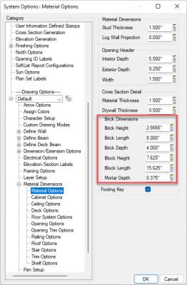

At the system level why is the material height of block showing 8" and mortar depth showing 1/4".  Can management please change this to 7-5/8"x15-5/8" and 3/8" as the default.  Clean up the brick also.

Posted 31 May 2022 - 02:30 PM
You can change it to be whatever you like.

Is there an easy way to change dimensions on icf blocks?
understood a block is not 8", the program should not reflect this as default.  Perhaps on V1 Softplan this could have been a good idea for simplicity.
