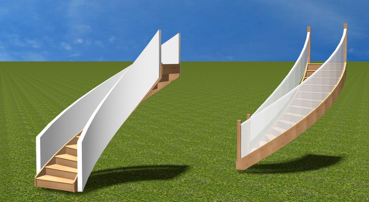

I need to create a 1/2 wall floating stair. Any great ideas

Draw the stair and then draw walls (or railings with solids to represent), raking the top and bottom to match the stair rise/run.

Challenge accepted. Down and dirty, but you get the idea....

Sorry Mark...not your fault but the ceiling on the underside needs added...and that is a big part of it.
#9 Allen McDonnell
Posted 14 September 2023 - 01:26 PM
And just like all cylinders and arches in softplan...it is jagged.  So not realistic.

It was very down and dirty. Not spending time cleaning things up for perfection (or more accurately - not quite perfect). You can add the ceiling and either make the stair wider to house the bottom of the wall (almost) or change the size and offset of the railing components to mimic the walls. You could also use all sorts of profiles in walls or a single wall material to not get the hollow underneath. Certainly the curvature is going to have the segments, but it is better with some texture and render settings. Then, if you take it into your Lumion program maybe it will be enough to sell the project. If not, the customer is too high maintenance anyway. So count your blessings and move on.
