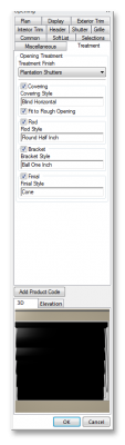

I don't know why, but I find the window treatment very awkward to use, On my installation, if you select a treatment, nothing shows until you check the boxes, and then it seems to be something different. However, changing the treatment after checking the boxes does NOTHING. Is this only my machine, or is this common. How would you change a white Curtain with Brass Rod to Dark Beige Curtain and Aluminum Rod? without editing all the boxes ... Shouldn't they change automatically?
The actual "TREATMENT FINISH" selected doesn't do anything ... Does anyone have any idea what's going on?
This is what my computer shows:
2017.06.14_13h27m10s_001.png 2017.06.14_13h28m45s_002.png 2017.06.14_13h29m07s_003.png

I think it doesn't change Keith because you selected blinds. If you select curtains, then changing the treatment finish will appear and change upon selection EXCEPT it doesn't seem to work for all selections.
#6 Keith Almond
  • 5,303 posts
Posted 14 June 2017 - 02:38 PM
I can reselect anything, HOWEVER, those seem to be the DEFAULT items whichever treatment I select ... NONE of which seem to have ANYTHING to do with the treatment selected. In which case why bother to select a treatment at all?

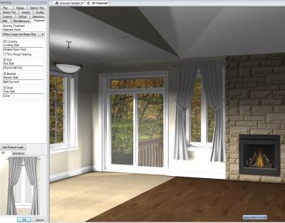

This is what I get when I switch between selections.

Thanks for the question Kylene. This topic seems to have gone off base so I'll attempt to answer your original question.
The distance the curtains sit from the wall is dependent on the length of the bracket used. The Ring half Inch is a shorter bracket that may give you the result you want.
If I misunderstood the question, please let me know.
