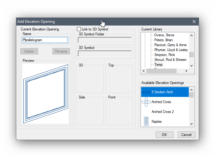

3.Go to FILE > SYSTEM OPTIONS > SYSTEM LIBRARY - Choose Library Type as ELEVATION OPENINGS > Select required Library - Click ONE STEP and draw a box around the window you have just drawn > OK

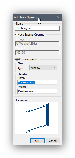

4. Change the library to OPENINGS - Again Select the required Library - Click ONE STEP - Name the Opening - Click Custom Opening Radio Button - Type (in this case) WINDOW - and select the library and window that you saved in Step 3 - OK

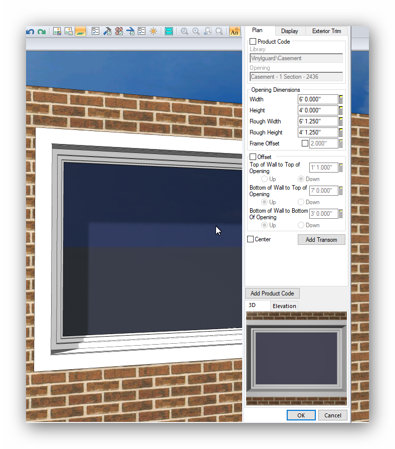

5. CONFIGURE OPENING - EDIT INDIVIDUAL COMPONENT and (again in this case) on the ELEVATION TAB change SILL TYPE to NONE - OK - OK - OK

Add a window similar to the one that you require on the plan - UNCHECK - PRODUCT CODE and EDIT ITEMS as required.
SIze:
Number of Sections:
Deflection:
etc. etc. It may be simple but it's still a custom window
When everything is how you want it CLICK Add Product Code, and save your custom window for posterity.

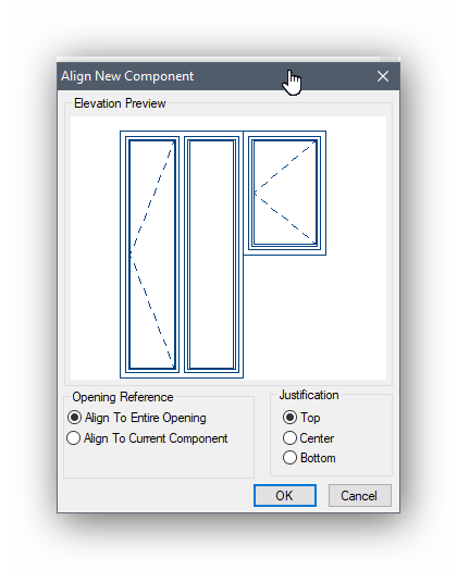

Go to FILE > DRAWING OPTIONS > DRAWING LIBRARY and select the product you just created ... EDIT SYMBOL ... ADD ... SELECT and OPENING and locate it and configure it to suit.... and carry on adding until satisfied ... EDIT INDIVIDUAL COMPONENTS to make each section what you want/need. You can edit each component for sections, grilles, deflection etc. etc.
OK - OK - OK
