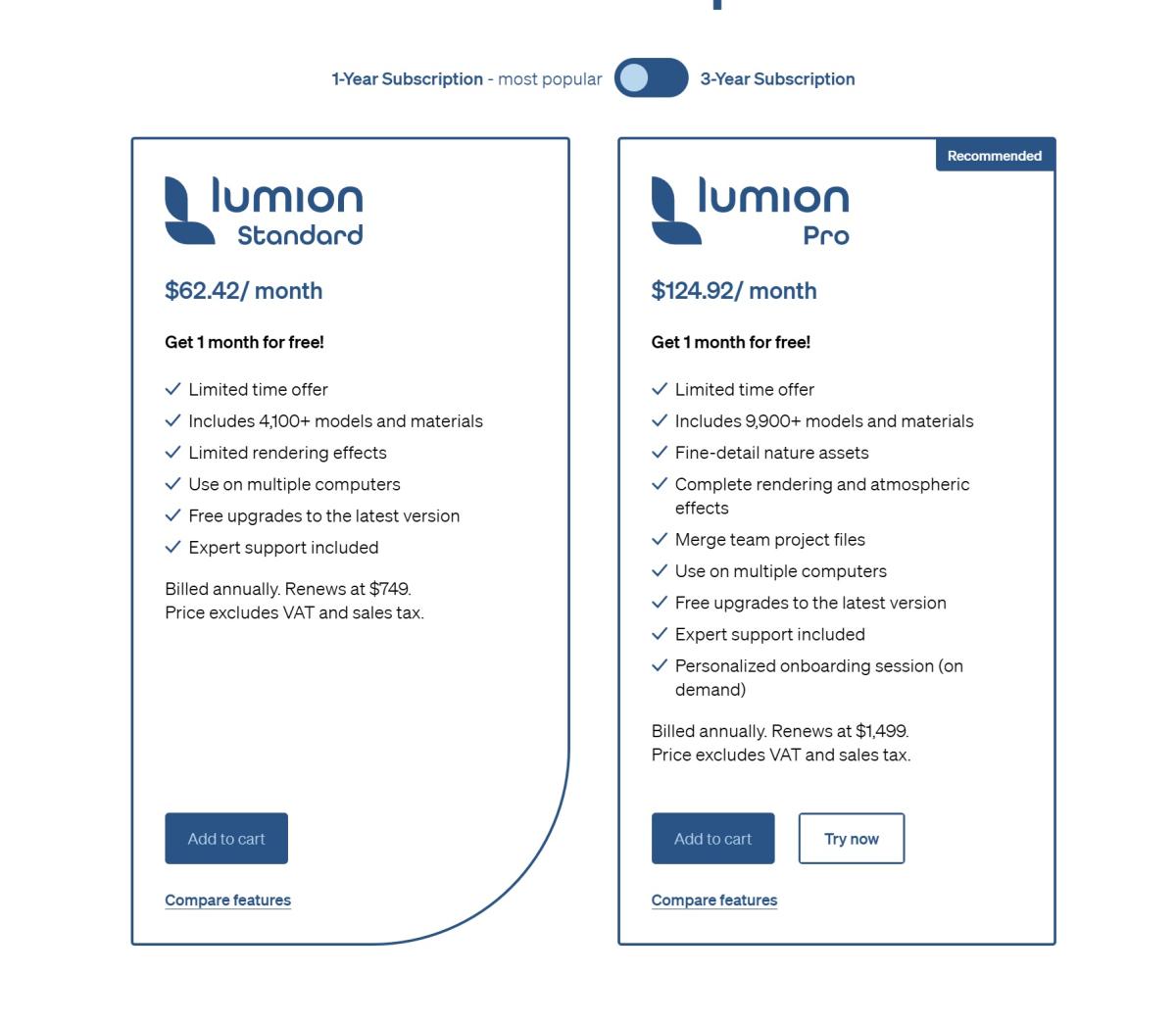

#5 Allen McDonnell
  • 1,212 posts
Posted 29 January 2025 - 09:54 AM
That is a really challenging comparison.
I cannot attest for TM....but the customer service at Lumion is some of the best I have received.  They will teach and help you in every way possible....from computer recommendations to how a normal map works.
If money at all is in question I would say stay with TM.   You will be stuck with a yearly sub fee with Lumion.  In american dollars it is $1499 per year....if you buy three at a time there may be some savings if offered at that time.
