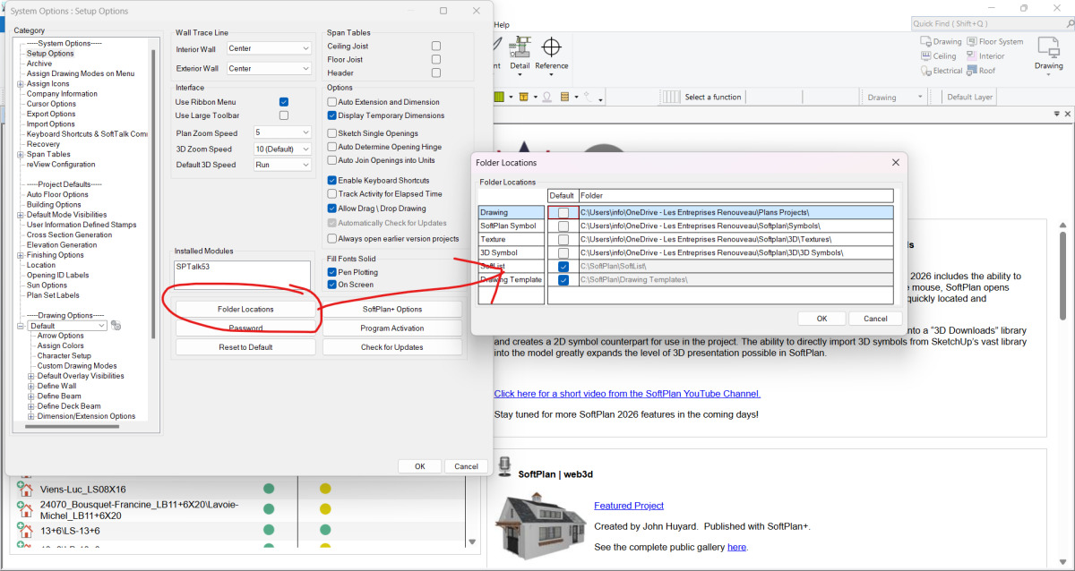

I have my symbols, 3d symbols, and most of my SP resources on OneDrive. It works quite well. There are some times when I open up the symbol dialog that it takes a little longer to load the 3d or the list of symbols, but I have worked successfully like this for several years. I believe that there are others on here who have done more or less the same thing.
Here are a few discussions on this subject.
https://softplan.com...loud#entry43935
https://softplan.com...loud#entry24696
There may be more.
You would need to update your default folders in System Options as in the screenshot.
