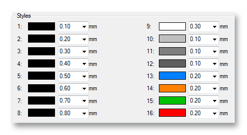

Assuming this is sort of what you're looking for....
My approach utilizes a symbol I've created that is comprised of Lines that are colour coded to the Line Weights (printed weights) I use.
I insert this symbol (the coloured lines to the left of the attached image) into my drawing (if I'm not already using an existing drawing), .. explode and use 'Select Item to Draw'
I can recognize a given line weight by its screen colour, .. but like Keith, .. my Configure Pen Print Styles is set differently (right side of attached image).
(The Print Pen Styles shown is set 'black' so my PDFs are created in black and white, .. my preference)

Doug ... Can you really tell the difference between 0.10mm, 0.11mm. 0.12mm and 0.13mm thicknesses? Shouldn't they be 1.0mm, 1.1mm, 1.2mm and 1.3mm? and pens 10, 14 and 15 are identical.

Keith, ..
Yes, .. there is a visible difference between them when printed, ..
These are Pen Weights that harken back to my hand-drawn-with-ink-pens days,
..the weights are pretty much the same as then, .. I used a .35 for lettering, .. a .50 for Wall Linework, .. and so on, .. .80 was a very think pen ..
EDIT, .. Just re-read your post Keith, .. I only use Pens 1 thru 8 and 16, .. the other pen weights I don't use so those were never set to be anything, .. hence the .10, .. .11, .12
I never really looked at those to see that they were that 'fine of a' differentiation
