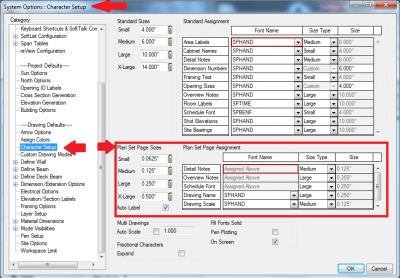

So having determined that the character sizes are nominally 1/48th of the size we normally use, Is there a way of setting default sizes, or do we have to resize all the notes in the drawing options for every plan in the plan set?

You can set default character sizes in drawing options -each plan set can have it's own settings

Never Mind, I found them,  I didn't realise I could resize the default note sizes for the plan sets from Character setup in System options.

System Options: Drawing Defaults: Character Setup
